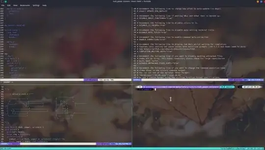

enter image description here https://github.com/HenzelMoras/myconfig
usding zsh shell with .zshrc which allows autocompletiion, suggestion extra using oh-my-zsh https://github.com/ohmyzsh/ohmyzsh
install if not present
sudo apt install zsh
change default shell to zsh
chsh -s $(which zsh)
install oh-my-zsh
sh -c "$(curl -fsSL https://raw.githubusercontent.com/ohmyzsh/ohmyzsh/master/tools/install.sh)"
then edit .zshrc file u can refer my config file settings
nvim ~/.zshrc
source the file
source ~/.zshrc
tmux for multiple split panels and windows
sudo apt install tmux
then Neovim 0.5 to to make terminal editor just like an idle
u can refer my dot files for examples
