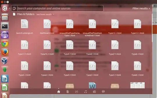

An image
An image to applications is shown like this, when looking at Ubuntu dash search feature.

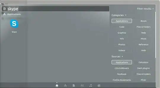

I finally found out why the installed Applications were not showing up. Check for Filters options while searching and select the Applications button.
Mine was not selected so it was listing due to filters applied.
screenshot
