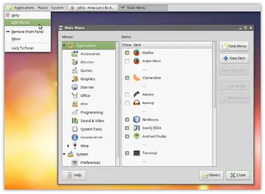

Right click the menu button and you can edit the menus to choose which installed applications appear. I had a similar problem & was surprised by the simplicity of the solution!
If you don't see the option, you first need to
sudo apt-get install alacarte
If Edit Menu isn't visible, do Alt+F2 and type alacarte.
