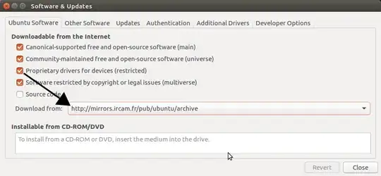

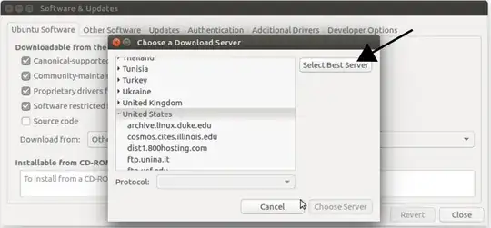

if you changed location, change your download server as well:
sudo software-properties-gtk
click other then select best server:
select best server 1 select best server 2

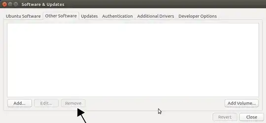

after that select and delete all other software repositories:
