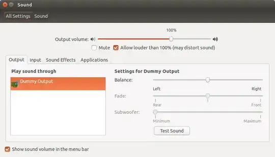

I recently tried to install Realtek audio driver. Procedure was completed successfully but when I rebooted system after installing my sound cards are not detecting and system is muted. Later I tried to take the system back to original state. Those steps are also completed.
Snapshot of my system Sound setting

Install common Sound card drivers and needed packages in Ubuntu.
sudo apt-get install build-essential linux-headers-`uname -r` alsa-base alsa-firmware-loaders alsa-oss alsa-source alsa-tools alsa-tools-gui alsa-utils alsamixergui
I tried using this page on the Ubuntu wiki to upgrade alsa and it worked for me.
Following these instructions will give you the latest ALSA driver, but only for internal "HDA Intel" sound cards (if your computer is from 2005 or newer, you almost certainly have a "HDA Intel" sound card for handling internal speakers, headphone jacks and microphones). USB or Bluetooth sound will not be affected.

I had the similar issue in Ubuntu 16.04 / Dell Inspiron 5559. Even my Bios was not detecting any Audio drivers.
I did tried to solve it by answers above but it did not worked. I tried to reinstall OS, but that did not worked too.
Finally I shut down my laptop and removed the Battery and restarted again. It worked.
But whenever I SUSPEND my Ubuntu, same issue occurs (neither Shutdown/Restart works). So everytime this problem occurs, I have to shut down & remove battery and audio works fine. Its a weird solution, i also don't know the reason behind it happening.

This also happened to me, and I followed these instructions, and now it works
1) Remove the ALSA packages.
sudo apt-get --purge remove linux-sound-base alsa-base alsa-utils
2) Reinstall the same packages.
sudo apt-get install linux-sound-base alsa-base alsa-utils
3) Install further audio addon packages (dkms included, but no worries since apt resolves package dependency for you)
sudo apt-get install dkms build-essential linux-headers-`uname -r` alsa-base alsa-firmware-loaders alsa-oss alsa-source alsa-tools alsa-tools-gui alsa-utils alsamixergui
4) Be sure to add the user to group audio
sudo usermod -a -G audio [user_name]
5) reboot
sudo reboot
