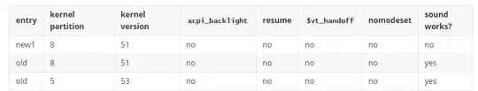

Testing
Let us only consider only the simple ext4 partition for now. The encrypted zfs partition behaves the same though (and the unencrypted zfs partition I haven't checked).
First of all, I have tried several combinations of boot arguments, but I think the following three tests should be enough for this question. table image
  • The first column ("entry") is either old for the ext4-menuentry with grub on p8 or new1 for the ext4-menuentry with grub on p5.
  • The kernel partition was set to 8 by editing the menuentry to contain set root=(hd0,gpt8) right before the line starting with linux and prefixing the path to the kernel and to the initrd with /boot.
    Analogously, the kernel partition was set to 5 by inserting set root=(hd0,gpt5) and removing the prefix /boot from the kernel and initrd paths.
  • Any column between (exclusive) ]kernel version, sound works?[ is about the presence of the respective kernel boot argument. Those are arguments that were set in at least one of the grub menuentries, but as you can see in the table, the behaviour remained the same without those.
I have also tested whether the presence of quiet splash has any effect, but it also does not seem to have any.
To be absolutely certain that the boot arguments don't have any impact, I tried booting from the grub terminal directly.

setparams 'Ubuntu'
recordfail
load_video
gfxmode $linux_gfx_mode
insmod gzio
linux /vmlinuz-5.3.0-53-generic root=/dev/nvme0n1p8
initrd /initrd.img-5.3.0-53-generic
Boots into emergency mode with "Failed to mount /boot/efi" (wrong fs type, bad option, bad superblock on /dev/nvme0n1p2 ...)
So I remove the gfxmode $linux_gfx_mode again and continue:
setparams 'Ubuntu'
recordfail
load_video
insmod gzio
if [ x$grub_platform = xxen ]; then insmod xzio; insmod lzopio; fi
insmod part_gpt
insmod ext2
Sound and brightness keys still work.
setparams 'Ubuntu'
recordfail
load_video
insmod gzio
insmod part_gpt
insmod ext2
if [ x$feature_platform_search_hint = xy ]; then
  search --no-floppy --fs-uuid --set=root  81e29369-ff69-4424-858c-3489283588d7
else
fi
setparams 'Ubuntu'
recordfail
load_video
insmod gzio
insmod part_gpt
insmod ext2
else
fi
I have inserted the gfxmode $linux_gfx_mode again and it still boots well and the Sound and Brightness Keys still work.
setparams 'Ubuntu'
recordfail
load_video
insmod gzio
insmod part_gpt
insmod ext2
else
fi
linux /vmlinuz-5.3.0-53-generic root=/dev/nvme0n1p8 ro nomodeset
And the screen brightness and Sound no longer work!
Again, without nomodeset:
setparams 'Ubuntu'
recordfail
load_video
insmod gzio
insmod part_gpt
insmod ext2
else
fi
The Sound and Brightness keys still work.
setparams 'Ubuntu'
recordfail
load_video
insmod gzio
insmod part_gpt
insmod ext2
else
fi
linux /vmlinuz-5.3.0-53-generic root=/dev/nvme0n1p8 ro acpi_backlight=video
Worth noting that I only had acpi_backlight=video there in the first place because the brightness keys were not working. And I had nomodeset(which currently seems to be the culprit) there because it fixes hibernation. Maybe nomodeset broke my brightness keys and sound, which I then tried to fix using acpi_backlight=video?
So including nomodeset again:
setparams 'Ubuntu'
recordfail
load_video
insmod gzio
insmod part_gpt
insmod ext2
else
fi
linux /vmlinuz-5.3.0-53-generic root=/dev/nvme0n1p8 ro nomodeset acpi_backlight=video
The sound and brightness are now not working, so it is unclear to me why the brightness fix with acpi_backlight=video worked for me last time. I applied it May 9 and the nomodeset was already in March... perhaps I removed and re-added that some time and didn't realize the effects it had on the brightness keys.
I would prefer having one problem over having two problems, so here's again removing nomodeset acpi_backlight=video and adding the final argument:
setparams 'Ubuntu'
recordfail
load_video
insmod gzio
insmod part_gpt
insmod ext2
else
fi
linux /vmlinuz-5.3.0-53-generic root=/dev/nvme0n1p8 ro resume=UUID=1ba104f0-35be-42f7-bf71-65e43f6fbcc3
As expected, sound and brightness work again. I have not tested hibernation now. I assume it will either work due to the recent bios and firmware update by lenovo, or still not work in the same way as in my question about it. But that will be a different problem for a different day.
Now for the question that remains: why did it seem like it worked in the old bootloader?
Well... turns out that in most of my tests did not modify "nomodeset". But in one that you can see in the table higher above, the sound did not work with the p5 bootloader, kernel 51 from p8, without acpi_backlight and without nomodeset.
I can no longer reproduce that. Perhaps I made a mistake while taking notes.
