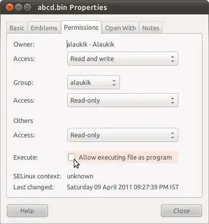

Right click and select properties then go to permissions tab and tick allow excecuting.
Now double click the file and select run.
Some binaries require to be run from a terminal. If that's the case with your .bin file and/or nothing happens after double-clicking, drag the file into a new terminal window and run it by pressing 'Return'. The output should give you a clue on what's wrong.
