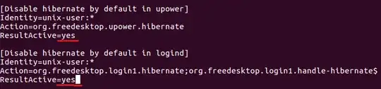

Just press Ctrl+Alt+T on your keyboard to open Terminal. When it opens, run the command(s) below:
sudo nano /var/lib/polkit-1/localauthority/10-vendor.d/com.ubuntu.desktop.pkla
Look for
[Disable hibernate by default in upower]
[Disable hibernate by default in logind]
Change the value of "ResultActive=no" to "ResultActive=yes" in both, press ctrl+x to exit the file. It will ask to save the change or not. Press Y to save the change, if you're on Ubuntu restart your system.
Edit
Just tried this on Xubuntu 16.04, and Ubuntu 16.04. and it also works.
For Ubuntu 16.04 I had to reboot for it to work.

For a novice like me, I would like to add:
"Just press Ctrl+Alt+T on your keyboard to open Terminal. When it opens, run the command(s) below:
Look for
[Disable hibernate by default in upower] [Disable hibernate by default in logind]
Change the value of "ResultActive=no" to "ResultActive=yes" in both, and then restart your system."
.....before restarting the system, you should press ctrl+x to exit the file. Then it will ask for Yes or No to save the change. If you don't save the change, it will not work. I am using ChaletOS which is based on Xubuntu. It doesn't need a restart.
