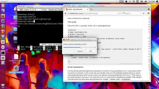

Update
I've wrote another script which uses zenity (graphical front end for scripts) and xrandr, with a desktop shortcut.
Tools you need
  • xrandr (should be installed by default, don't quote me on that) and knowing the name of your display
  • zenity (should be installed by default, don't quote me on that)
  • desktop shortcut backlight.desktop
Desktop shortcut
Create backlight.desktop file on your desktop and make it executable with sudo chmod a+x ~/Desktop/backlight.desktop. (Note, you may want to make it executable through rightclick -> properties and also allow running text files as executables in Nautilus-> Edit-> Properties-> Behavior).
[Desktop Entry]
Type=Application
Exec=/usr/bin/backlightscript
Terminal=false
Icon=/usr/share/icons/HighContrast/16x16/status/display-brightness.p
ng
Note, Icon portion is optional.
The script
Place this file in /usr/bin folder, call it backlightscript
#!/bin/sh
# Name: backlightscript
# Author: Serg Kolo
# Date: March 2 , 2015
# Description: Simple script to change screen brightness using xrandr
# uncomment this for debugging as needed
# set -x
NEWVAL=$( zenity --scale --min-value=0 --max-value=7 --text="Enter number between 0 and 7" ) && brightness=$(($NEWVAL+2))
if [ $(echo $?) = 0  ]
  then
    xrandr --output LVDS --brightness 0.$brightness
fi
Script explanation
I've found that optimal brightness is between 0.2 and 0.9. If you go bellow 0.2 or 1 screen gets either too dark or too bright. In this script, the user double-clicks on the backlight.desktop shortcut, which calls graphical pop-up with a scale, where user selects necessary brightness from 0 to 7. That value is incremented by 2 ( so max is 7+2=9 and min is 0+2=2 ) and stored in brightness variable. That variable then becomes the value after decimal point for xrandr --output LVDS --brightness 0.$brightness.
The if - then block is used to test whether the user actually selected something. Without it, xrandr will set brightness to 0, in which case you won't see anything on your screen, even tty1, and will have to either reboot or do Alt+SYSRQ+R+E+I+S+U+B
Note, that xrandr is a software solution, not hardware solution, i.e. you're not changing brightness of screen directly.
How it should look
