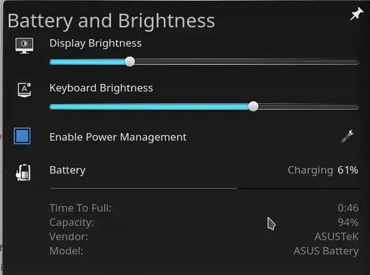

If you click on the battery icon, and if you see a slider to change the brightness, and if it actually works ie. if the screen brightness changes, then the functionality is there, you just need to re-map the keyboard keys.
(So no need to mess with kernel parameters & drivers & such)
If you click on Battery icon in KDE Panel and see this:
battery panel
In the System Settings → Workspace → Shortcuts → Global Keybard Shortcuts → KDE Daemon you will find Decrease Screen Brightness and Increase Screen Brightness.
It seems to be already mapped to Fn+F5 / Fn+F6, but it doesn't seem to work, so just give it a Global Alternative mapping to Meta+F5 / Meta+F6 instead.

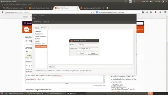

IF u want to change brightness through keys Follow this :
sudo apt-get install xbacklight xbacklight -set 50
Then open Settings>keyboard>shortcuts
Add custom shortcut keys and enter following commands there: enter image description here
xbacklight -dec 10
xbacklight -inc 10
