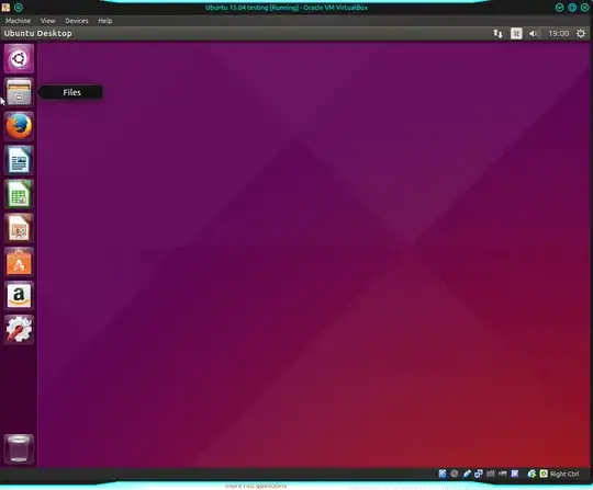

  1. Start the machine enter image description here

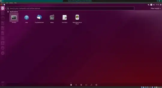

  4. Open the terminal from the launcher enter image description here

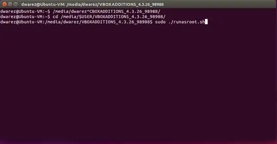

  5. Write cd /media/$USER/VBOXADDITIONS_4.3.26_98988 (if the name of the CD is different, check it in Files) and press Enter.
  6. Now, write sudo ./runasroot.sh and press enter. enter image description here
  7. Insert the password and press enter
Done. It should work fine and without any efforts.
