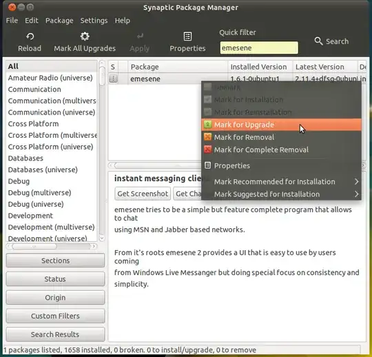

  2. UsingSynaptic Package Manager: Right click→Mark for upgrade:
    Note: Sometimes it may asks for additional packages or dependencies, it is normal.
