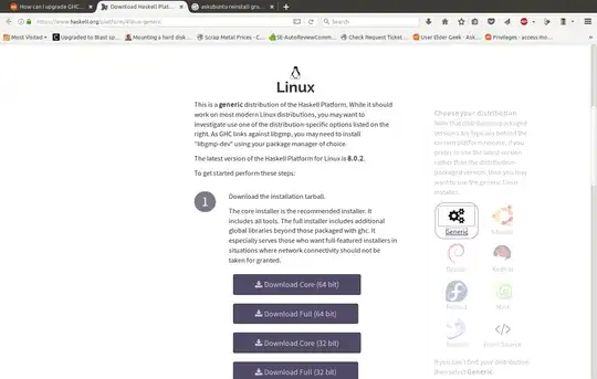

The only way you can get the latest version is to install the Generic Linux version following the directions found here.
0) Always remember to safeguard your system against unintended consequences with a good backup strategy.
1) Download the installation tarball from the page shown below:generic-haskellthat matches the architecture of your installation and verify the hash matches with the command sha256sum filename where filename is the name of the file you downloaded.
2) Extract the content of the archive and note where you are extracting to.
3) change to the directory you extracted to in the step above and run the installation script with sudo ./install-haskell-platform.sh
Note: There are further details on the installation page for those of you running Ubuntu 16.10 or higher.
