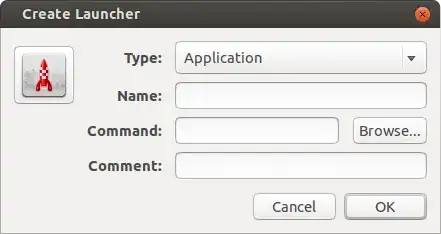

You can create a launcher by using following command:
gnome-desktop-item-edit --create-new <path-where-to-save>. I t will open this window.
Name it whatever you like and in command box type following
sh -c '/opt/idea/bin/idea.sh' and save it.
Now you can run that file using newly created launcher
