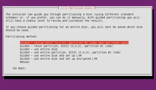

  • Use the Ubuntu Server Live Image to resize the partition. For this case, you will need to get to this screen:
    And choose the Resize option as shown in the image above. From there you will select what the new size will be since from here you can unmount the unit and shrink it if you want.
