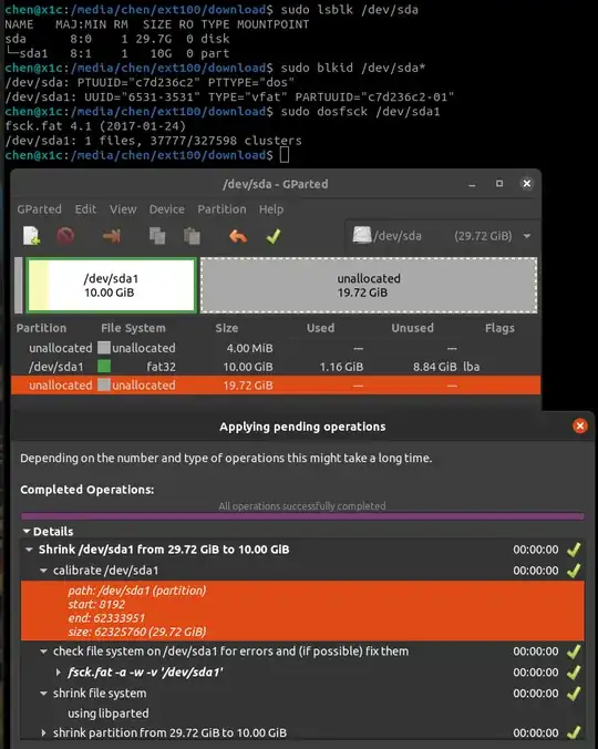

update1:
seems gparted will resize fat fs in step 1.
// but if fs mounted, it may fail, but not suspend
here is normal log and result:
