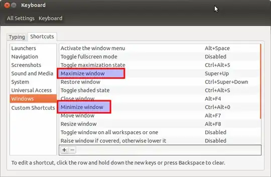

If you are on unity, then click the cog in the upper- right corner and choose System Settings
Now find the Keyboard entry, there you will be able to edit all your shortcuts.
You are looking for Maximize window and Minimize window they can be found under Windows. Just set the shortcut to whatever you want it to be.

You can maximize windows by Super+̣↑ and minimize by Ctrl+Super+̣↓.
For more keyboard shortcuts hold down Super or take a look at System SettingsKeyboardShortcutsWindows.
There you also can re-enable the old behaviour, but you have do disable the F10 keybinding first, which is described here.
