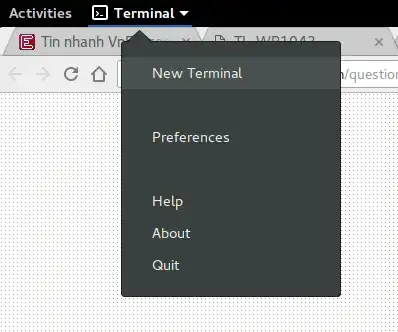

Ubuntu Gnome 16.04 LTS

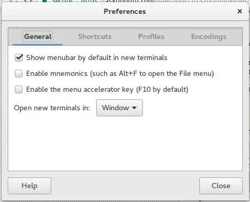

In terminal, hit Windows (super) key + F10 to open Application menu:
Click Preferences, and untick Enable the menu accelerator key (F10 by default):

If you're using gnome-terminal, go to Edit > Keyboard Shortcuts. There is an option to unbind F10 from the file menu. Unfortunately there doesn't seem to be an option for F11. But note that F11 is a system-wide shortcut for full-screen.
