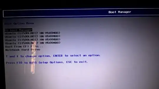

I use a HP Pavilion machine with Windows 8.1 and Ubuntu 14.04 in dual boot. Whenever i start the system, it boots to windows. I tried to use
bcdedit /set {bootmgr} path \EFI\ubuntu\grubx64.efi
from Windows as I saw in this link. Grub not showing on startup for Windows 8.1 Ubuntu 13.10 Dual boot. What I ended up with is multiple entries of Ubuntu in Boot Device Options of my BIOS. Clicking one of those boots me to Ubuntu. Now I don't know why I see this list is increasing. The last time I booted in I saw 7 entries. I don't understand any thing what is happening. Please help. Everytime i boot to Windows this list increases.BIOS Boot Manager
BIOS Boot Manager
