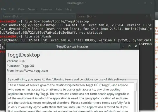

There isn't need of the ia32-libs package anymore (since 12.04 to be exact), if you use the APT system, you have nothing to worry about installing 32-bit packages in a 64-bit system. This happened since the introduction of multiarch, one of the Debian most game changing policies in the way Debian manages it dependencies. This method allows to have different binary targets in the same system without care of the kernel architecture. This doesn't mean that you can run any 32-bit package without preparation, but if you install the libraries/binaries any applications in theory should be able to run. This is true from 64-bit to 32-bit and vice-versa.
For using such method is recommended using the APT managers, to prevent unmet dependencies. The changelog includes a small history about how the changes were made:
  1. In precise the package was emptied and made a transitional package. It was added several dependencies against packages that hasn't been moved to multiarch.
  2. Slowly but surely, all packages were rebuild with multiarch support and the reverse dependencies were being dropped or changed to ia32-lib-multiarch. When theses packages stop needing the ia34-libs packages the dependencies were dropped at the same time. The dependencies were changed from ia32-libs to package:arch being package the name of the library needed and arch the architecture (below there is a example with skype).
  3. With the last release the ia32-libs-multiarch package was removed from pre-raring releases and ia32-libs don't got published to saucy. All Ubuntu packages are multiarch capable and you can install different architecture packages in your system.
Now, when installing a package that needs 32-bit binaries, if you don't pay attention you will never know that you are using a 32-bit package, since the package manager will pull automatically the necessary dependencies:
