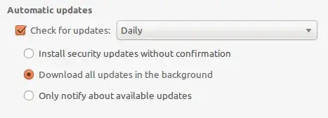

Optional: For maximum efficiency you should set one machine to automatically download updates, so that when your other machines need it it's already in the cache. You can do this by going to System->Administration->Update Manager, then click on the "Settings..." button, in the Update tab set it to automatically download all the updates.
alt text
