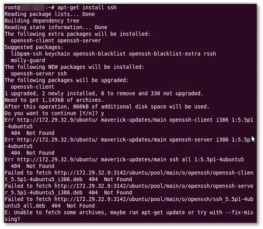

Error in client on installing packages enter image description here
Can anyone sort out pls?
