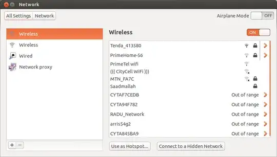

will open a window for network management which should be similar with:

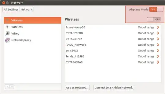

Airplane mode on
You can observe that at this moment the "Airplane Mode" is off and the wireless is on.

The above window will be changed automatically to:
Airplane mode on
As you can see, now "Airplane Mode" is on and the wireless is off.
