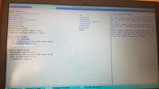

furthermore, I did reset my BIOS which didn't change the situation. Suggestions where to look in the BIOS whether the adapter is disabled. (But in Windows the Wi-Fi works perfectly), I have a picture of this:
Network Adapter
Lastly, one suggestion was to look for a key on my laptop that enables/disables the Wi-Fi adapter, as far as I know I can't find one. My laptop is a HP Pavilion Power 15-cb091nd.

  1. Look at the version of BIOS that you have installed. If it's not F.17 Rev.A (Dec 10, 2018) then go to the HP Support Site and download this BIOS update and install it. Reset the BIOS back to factory defaults... leaving Secure Boot disabled, if required. Retest wireless.
