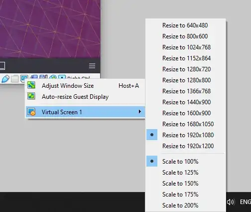

Just right click on the image of the monitor in the bottom right of your running VM and then change the resolution to the desired one.
Scale and Resize options list
I struggled too to figure it out ;)
