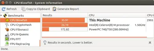

Install hardinfo which gives benchmark information as shown below screen-shot:
sudo apt-get install hardinfo
