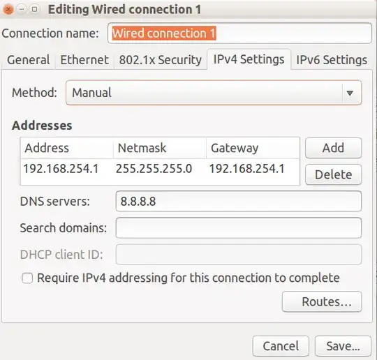

Because of how the RasPi is configured (to work with several other systems), I want eth0 to use 192.168.254.1. If I configure eth0 to manually use 192.168.254.1: Manual eth0 configuration
the RasPi connects to my laptop and I am able to ssh into it. However, although I still see a valid wlan0 configuration when running ifconfig, I'm unable to access the internet (presumably my laptop is trying to use eth0 instead of wlan0).

Your configuration has a fundamental problem. Your gateway is set to the same IP address as your local IP address.
A graphic: Raspi: connect to 10.0.0.5 Raspi: not in my subnet, send to gateway Raspi receives request again and responds with the same message.
Your question is a bit confusing, but it seems that your laptop should have an IP like 192.168.254.2
