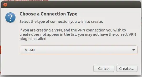

You could've done it easier than this. If your internet connection is established via some sort of routing device you can just make a VLAN for the connection you want to share internet with to make it to have access to the router subnet.
https://wiki.ubuntu.com/vlan
You can do this in Network Manager GUI easily. Afaik it is available outta box.

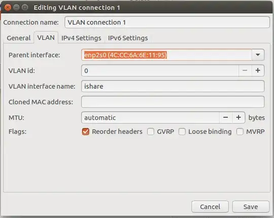

Add a virtual connection in NM. Pick VLAN as a connection type.
Parent device is the interface you want to share internet with. After that go to IPv4 settings and set an IP address for it from the router DHCP range. Voila. You got yourself a shared internet connection.
