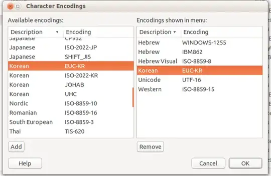

The easiest way to specify the encoding when opening the file is to use the Open Files dialog.
On the bottom left, you will see an drop-dwon option for Character encoding. If you haven't used the encoding in Gedit before, scroll down to Add or Remove....
In the new dialog, scroll down the list of Available Encodings until you find the one you want, then click Add to send it to the list of encodings on the right, then OK.
That's it. After that you easily open the file with the correct encoding.
