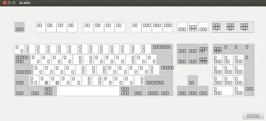

I just upgraded from 12.04 to 14.04. Now any Arabic text is displayed as squares, as shown in the image below. I tried installing the Arabic language pack but this did not solve the problem.

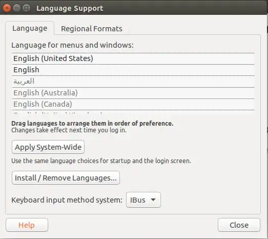

1-After installing arabic language you should see in languages menu if you not see you should add by check arabic from install/remove languages.
2-if still the same after rebooting in regional formats tab temporary choose العربيه after rebooting change it again to your default language.
Note : if prompt to update an external feature you should update.

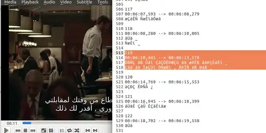

i have same problem with subtitle file but it depend on application as you see gedit have a problem with the file but on vlc on subtitle tab subtitle language section i edit the the default language to arabic and works fine .image as you see it depends on how application encoding language and here is away to change gedit encoding .
