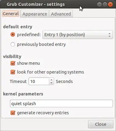

I used to use startup manager, as pointed out by Chad--24216, but alas, it's no longer being maintained, nor is it in the repositories.
It has been superseded by "grub-customizer", which while up to date, is also not in the standard repositories. To to add and install it simply do the following at the terminal:
sudo add-apt-repository ppa:danielrichter2007/grub-customizer
Press enter to confirm adding the PPA
sudo apt-get update
sudo apt-get install grub-customizer
Press Y to confirm
You can now launch grub-customizer in the usual ways. If you ignore the complete list you'll see when it first launches, and just press "Preferences" button on the toolbar you'll get a nice summary dialog where you can change the timeout value and default menu item, as shown below:
Grub Customizer preferences screen

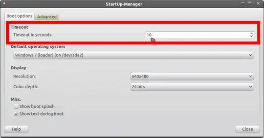

There are two ways to do it
  1. Start-up Manager (Development discontinues)
  2. Grub customiser (Not in the official repositories as yet)
Using Start-up manager (available upto 12.04)
Install it by typing:
sudo apt-get update
sudo apt-get install startupmanager
  1. Open up start-up manager
  2. Change the timeout setting to 10 secs
Using Grub Customiser
  1. To to add and install it simply do the following at the terminal (You need to add a PPA):
    Press enter, then type
    sudo apt-get update
    And press Y to confirm
  2. Click on the General tab and change the time out to 10 secs
Hope that helps.
Ashu
  • 9,642
Web-E's answer is really the best way to do it. However, if you want a GUI way of modifying GRUB that doesn't involve editing a file, you can download an install "startupmanager" from USC or Synaptic. Or with Universe repo enabled, you can open Terminal and install by typing:
sudo apt-get update
