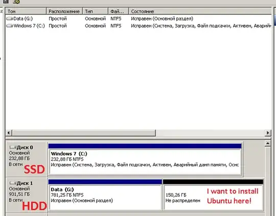

So my situation is this: I have 2 Drives. 1 HDD(1TB) 1 SSD(about 230GB). I use SSD completely for Windows 7(with one partition only). I also use big part of HDD as NTFS storage for that windows(I called it 'Data'). I want to install Ubuntu on whats left. Here is a screenshot:
My Drives: enter image description here
Is it possible to do it like that? If so, what options I need to select during drive questions in order not to kill MBR and be able to load to both Windows and Linux?

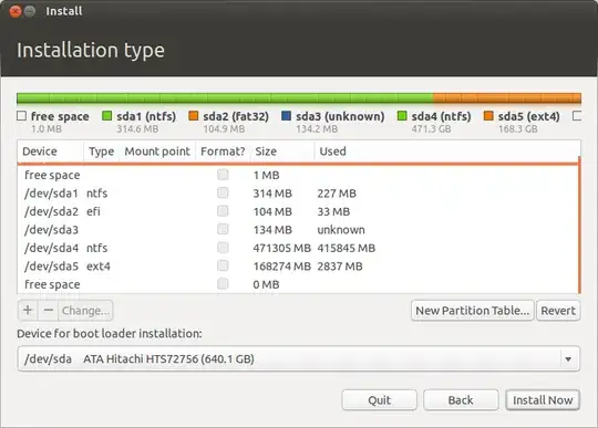

Please leave a comment under my answer with which option you want to do, and also with a picture from the "Something Else" installation option, and I'll be more than happy to guide you through the partition setup.
Do not select "install alongside Windows"!
Select "something else", as shown in this picture.
I need you to take a picture of what this screen looks like for you in the installer:
