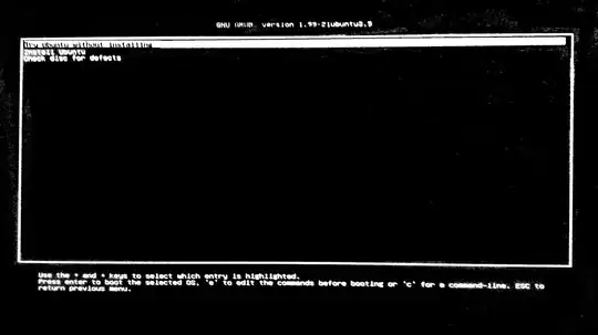

I was able to run memtest86+ with Ubuntu 16.04 Server USB stick with option Test Memory. This page shows the Boot options:
The desktop version showed only option to Try Ubuntu or Install Ubuntu as in this page:
