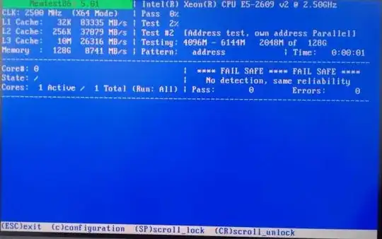

Due to the comment on my question Why low swappiness (10) leads to system crashes? I decided to run memory test.
When It starts automatically with the default "Fail-Safe" option, the screen seemed to be frozen (only red "+" was blinking) at Time: 0:00:01:
There is no response to neither (ESC) nor (c) and I may only guess what SP or CR stand for.

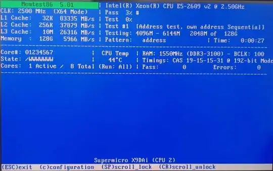

When I run "Multi-Threading (SMP)" option, screen changes for the first 27 seconds, and (c) responds with a list of options. Then the screen seems to be frozen again:
Is it some misbehavior, or does the test requires screen to be frozen?

If it looks like it is frozen, it is frozen.
It is a known bug of Memtest86+ 5.01 coming with Ubuntu 20.04.
In my case the solution was to use ISO with Memtest86+ 6.20 downloaded from https://memtest.org.
