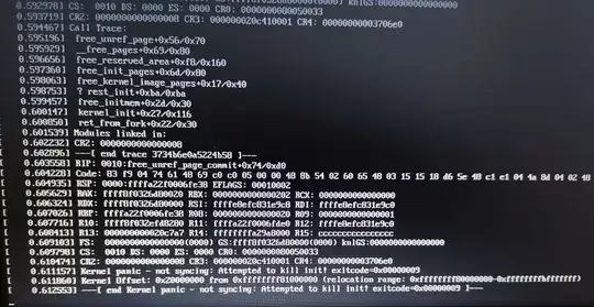

A few days ago Ubuntu froze and I hard reboot the laptop and when I wanted to boot Ubuntu again this message showed up. enter image description here
After searching a lot on the internet, I tried to boot with older kernels and also I booted Ubuntu with different grub parameters (like nomodeset), and every time I faced different kernel panic errors as you can see (and sometimes "Fixing recursive fault but a reboot is needed"): enter image description here
So I booted ubuntu via recovery mode and I saw weird behavior on the screen. By the way, I was able to enter the root shell prompt and I saw my files too. I Also copied my necessary files to a USB. But the root shell prompt was unstable and after 1 or 2 minutes same errors appeared on the screen I was no longer able to work with it and the only solution was rebooting.
After all of these, I booted from a Ubuntu bootable live USB for any chance of backing up my data and when the disk's process was completed, it was just a blank screen.

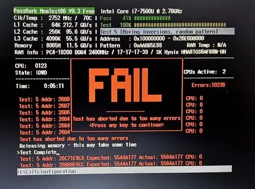

After searching on the internet and seeing the signs of this problem (Like freezing the screen or special kernel panic errors), I thought that the problem could be from RAM. I found a program called memtest86 which can do some tests on RAM.
So from here, I downloaded the .iso file and created a bootable image of memtest86 on a USB, I did the tests on my RAM(See usage here) and as you can see, it was able to find more than 10k errors.
So I replaced my RAM with a new one and now everything is working fine.
