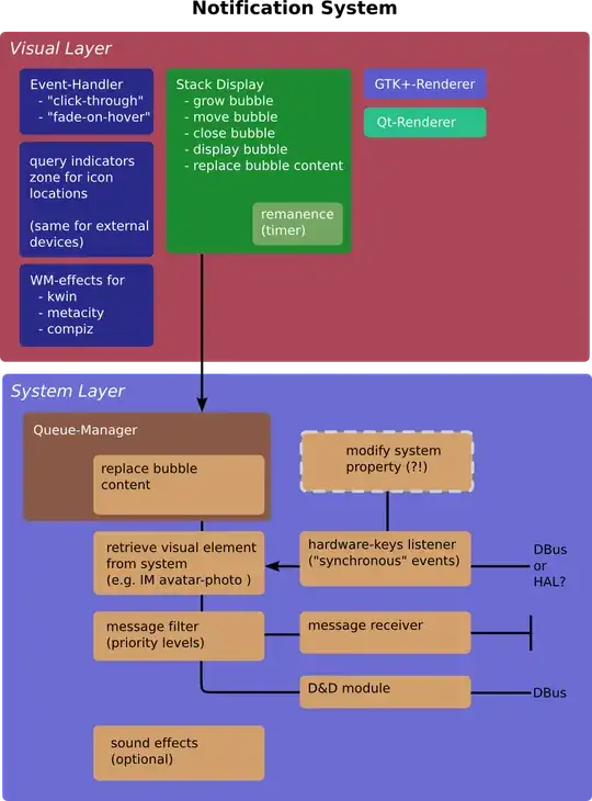

Check this out about NotifyOSD https://wiki.ubuntu.com/NotifyOSD#Volume_changes
If you look a These diagrams: https://wiki.ubuntu.com/NotifyOSD#Architecture
Especially this one: enter image description here
It shows that there is a "hardware keys listener" which receives form DBus or HAL? It then "retrieves visual element from system" which the sound and brightness icons are in the source of Notify-OSD, and then makes the bubble from there.
This is all crazy confusing, but as far as I understand it (so far):
raw scancode (ex. e016) > keycode (ex. 160) > keysym (ex. XF86AudioMute) > gnome-settings-daemon (ex. volume-up) > DBus signal > hardware-keys-listener for notify-osd (or other program listening)
