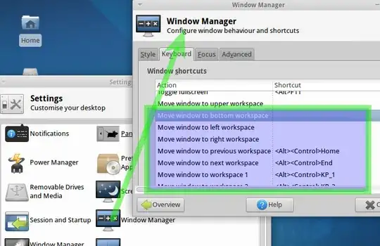

Keyboard shortcuts are tucked away in your Settings Manager - Window Manager - Keyboard
Scroll down the list - you will see several workspace shortcuts, some defined with a shortcut and some awaiting to be defined.

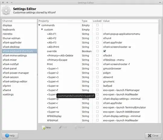

There are more available in Settings Editor in Settngs Manager, which can be launched from the command-line using:
xfce4-settings-editor
This will display:
XFCE4 Settings Editor
