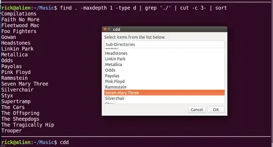

I wrote a script this afternoon to make it easier to change directories.
Usage
When you call cdd and there is more than one sub-directory you need to pick one:
In this screen if you click OK button it is equivalent to:
cd Seven\ Mary\ Three
or:
cd "Seven Mary Three"
When you call cdd and there is only one sub-directory it automatically changes to it:
rick@alien:~/Music/Seven Mary Three$ cdd
rick@alien:~/Music/Seven Mary Three/American Standard$
When you call cdd and there are no sub-directories an error is displayed:
rick@alien:~/Music/Seven Mary Three/American Standard$ cdd
No subdirectories
