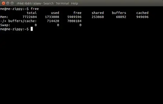

the system will happily use it again. If you have plenty of RAM you may not need swap at all. Issue the command
free
when the system is under heavy load and see how much is in use to make this determination.

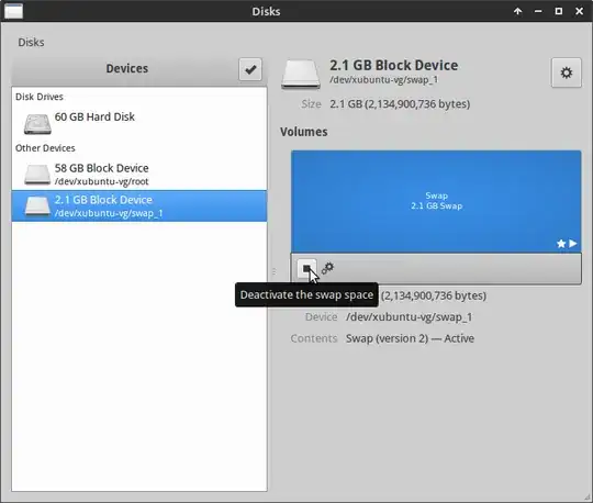

Go into a terminal and execute this command: gnome-disks. It is not installed in all distributions. If so, follow the instructions printed to install it and try again. Look for a device with the word 'swap' on the left pane. It usually has a size the same as your physical memory. Click the square button to disable it. Authenticate this change with your root password.
Screenshot:
Enter image description here
In the System Monitor application (gnome-system-monitor), you will see it reports the swap area as 'not available'. The swap area is disabled, but not deleted. You can enable it easily again in the future. Deleting the swap space has caused my system no harm, but you will create more work for yourself if you do decide you want it back (hibernation) in the future.
To prevent it from mounting at startup, you should go into the "Edit Mount Options..." in gnome-disks and uncheck "Mount at startup".

Now checkout the output after reboot, your swap never get mounted:
$ free -m
              total        used        free      shared  buff/cache   available
Mem:           3791         100        3408           8         282        3483
**Swap:             0           0           0**
