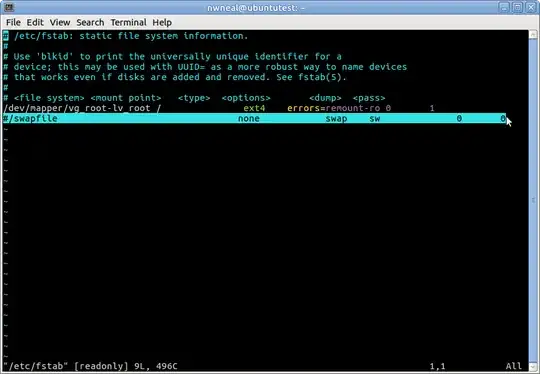

Now disable the swap file in /etc/fstab. I'm using Vim.
sudo vim /etc/fstab
Your /etc/fstab file should have a '#' in front of '/swapfile'
After this is done. save your changes and exit.

Any swap file or partition that starts at boot is in the /etc/fstab file. If you remove the line associated with that swap file in the fstab it won't start up again after a reboot.
