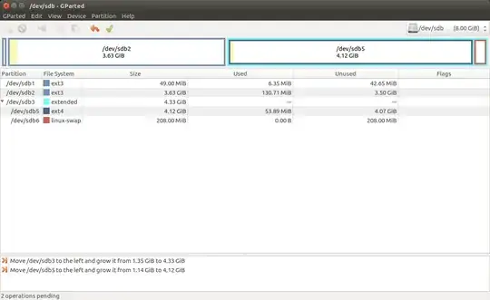

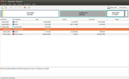

  1. You need to resize the extended partition (aka /dev/sda4) to make some room resize extended partition

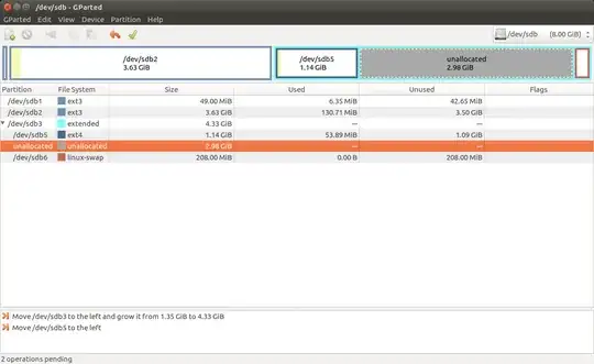

  2. to move the start of /dev/sda5 move sda5
  3. and then later grow/resize /dev/sda5. grow sda5
