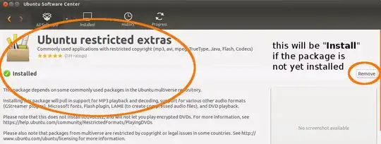

ubuntu-restricted-extras package allows users to install ability to play popular non-free media formats, including DVD, MP3, Quicktime, and Windows Media formats.
To install ubuntu-restricted-extras package:
  1. Open a terminal by pressing Ctrl+Alt+T.
  2. Run this command:
     sudo apt-get install ubuntu-restricted-extras
  3. Alternatively, you can install the package via Software Center by launching it via Dash and searching the package and clicking on Install.
