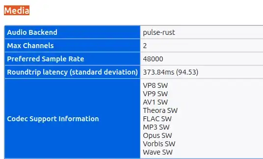

The problem is that AAC SW is not in following list in about:support

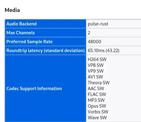

While in SNAP version of firefox I get the list
I have no idea what causes this difference: the way how firefox is built in SNAP versus .deb ?
[Edited 2023/06/09] This package ubuntu-restricted-extras made AAC SW available in VMware Workstation Guest Ubuntu 23.04.

Things that don't work in firefox from mozilla PPA on my main Ubuntu 23.04 are:
  • Print to pdf makes file of size zero
  • Save webpage makes file of size zero
  • AAC SW and H264 SW are not present in about:support section Media
There must be some other directory where .deb firefox keeps its settings. I already removed ~/.mozilla and got a brand new firefox, but still suffering from the same.
