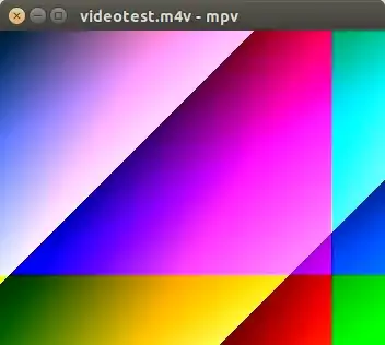

Are you building "video_encode" in or out of tree? If later you'd need to have libavcodec-dev installed. If former then you'd first need to build the ffmpeg source. Based on you using a gcc command I'd guess out of tree.
Note that it's actually named encode_video.c in the ffmpeg source ( no matter.
Works fine here in an out of tree build to produce the expected encoding ( i.e, 1 sec.
Ex.
$ ./video_encode videotest.m4v mpeg4 Send frame 0 Send frame 1 Write packet 0 (size= 6467) Send frame 2 Write packet 2 (size= 3281) Send frame 3 Write packet 1 (size= 1874) Send frame 4 Write packet 4 (size= 3579) Send frame 5 Write packet 3 (size= 2069) Send frame 6 Write packet 6 (size= 4389) Send frame 7 Write packet 5 (size= 2204) Send frame 8 Write packet 8 (size= 3538) Send frame 9 Write packet 7 (size= 2348) Send frame 10 Write packet 10 (size=13024) Send frame 11 Write packet 9 (size= 2303) Send frame 12 Write packet 12 (size= 4718) Send frame 13 Write packet 11 (size= 2504) Send frame 14 Write packet 14 (size= 5082) Send frame 15 Write packet 13 (size= 1898) Send frame 16 Write packet 16 (size= 4186) Send frame 17 Write packet 15 (size= 1842) Send frame 18 Write packet 18 (size= 4676) Send frame 19 Write packet 17 (size= 1782) Send frame 20 Write packet 20 (size=12942) Send frame 21 Write packet 19 (size= 2237) Send frame 22 Write packet 22 (size= 5180) Send frame 23 Write packet 21 (size= 2312) Send frame 24 Write packet 24 (size= 4520) Write packet 23 (size= 2523)
enter image description here `
