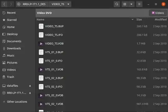

I installed restricted extras, multiverse, other codecs over a week period periodically found out how to get libdvdcss2, and libdvdread4, both where not supplied by the terminal, bash or shell. libdvdcss2 was installed by a Firefox hot linking method-2. libdvdcss2 was then installed via Ubuntu Software, libdvdread4 found via; "pkgs.org" apparently generic 18.04 .deb file installer. Was was wondering? Why are these codecs no longer in repositories or terminal bash shell for Ubuntu 20.04 or 21 editions? I had some really bad DVD playback as in the below image with XBMC's new Kodi player, an menu options with VLC. SMplayer played the DVD correctly, although it could not highlight menu options with the mouse cursor at all. I tried many other video players. They all have similar results, a trashed screen with weird lines and blue people looking like the smurfs.

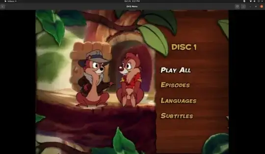

Answers found; " MPV media player loading dvd files directly
[MPV plays dvds's vlc gets buggy errors][3]
VLC and Kodi's XBMC when playing DVD:
