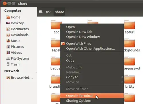

You have to install the nautilus-open-terminal package from the universe repositories for Ubuntu versions up to Ubuntu 15.04:
sudo apt-get install nautilus-open-terminal
If you want to install it with apturl, use this URL: apt://nautilus-open-terminal
Then:
nautilus -q
In order to restart Nautilus
Result
