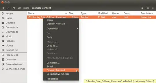

The official version nautilus 1:3.14.2-0ubuntu12 from 15.10 (Wily Werewolf)'s official main repository already includes the Open in terminal functionality.
If you check any folder's context menu, you'll see it's already there without installing any additional package. So nautilus-open-terminal is not necessary on 15.10 systems any more.
I can proof this by showing you my list of installed packages containing "nautilus" in their name:
$ lsb_release -d
Description: Ubuntu 15.10
$ dpkg -l | grep nautilus
ii libnautilus-extension1a 1:3.14.2-0ubuntu12 amd64 libraries for nautilus components - runtime version
ii nautilus 1:3.14.2-0ubuntu12 amd64 file manager and graphical shell for GNOME
ii nautilus-data 1:3.14.2-0ubuntu12 all data files for nautilus
ii nautilus-sendto 3.8.2-1ubuntu1 amd64 integrates Evolution and Pidgin into the Nautilus file manager
ii nautilus-share 0.7.3-1ubuntu5 amd64 Nautilus extension to share folder using Samba
Actually the functionality was already included into Vivid (15.04)'s nautilus package, but the nautilus-open-terminal package also still existed. Therefore if somebody installed the add-on, he suddenly had the context menu entry Open in terminal... twice!
Actually, you also need to have gnome-terminal installed for this to work. Might be interesting for all users not having installed the full gnome desktop, but e.g. xubuntu and nautilus.
It's not going to fall back on any other terminal you might have installed...
