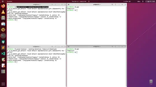

My terminal always opens in home directory no matter where I open it. I also tried opening another terminal in the different directory but it's not working
gnome-terminal --working-directory=Downloads
gnome-terminal --working-directory Downloads
gnome-terminal --working-directory /home/avil/Downloads
I have also reinstalled both open in terminal extension and gnome-terminal but it's still not workingenter image description here

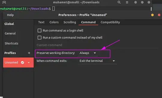

  • Open terminal
  • Go to Preferences
  • To your profile of the terminal(if you don't have any, create one)
  • In the menu of profile go to Command
  • Preserve working directory make it Always This fixed for me. Check the picture for more details.
