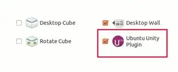

try go to compiz settings manager.To install it run command
sudo apt-get install compizconfig-settings-manager
and check if ubuntu unity plugin is enabled
also check decorating windows is enabled in effects. enter image description here
