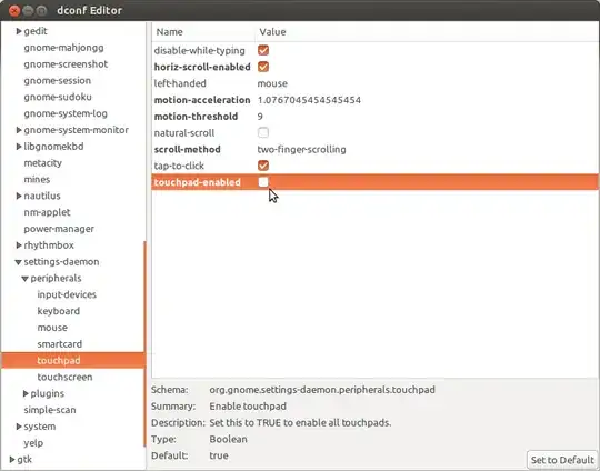

I don't have a touchscreen to test it but you could install dconf-editor
sudo apt-get install dconf-editor
And try to disable the touchscreen like I did for my touchpad, there's a dedicated entry for touchscreen, just below touchpad:
